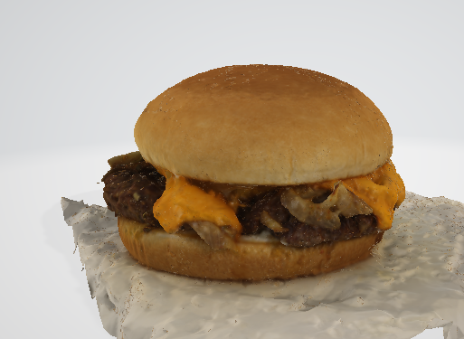

    So the close range/high details was what yielded my first results. Good model, just the detail on the wings were lacking, at least for how I wanted it to be.
    These were imported and used all high settings on the point creation, but 50% at resolution for the image scaling. These, I believe, gave a much better sparse point cloud then the first one. Then I used all high settings for generating the dense point cloud. That is were I thing something may have got warped or changed, as when it was done creating, the dense cloud didn't seem completely fluid and seems fuzzy, or our of focus on the wings.
    Then I tried making the mesh, that you see above, with very high on the poly count, smooth type, 70% water tightness, 30% on smoothness. I didn't use photoconsistency for that model. Tried it an got the result above.
    Tried the photoconsistency settings, using the recommended settings for "Mesh with noise, high quality images" and only got a slightly better result.

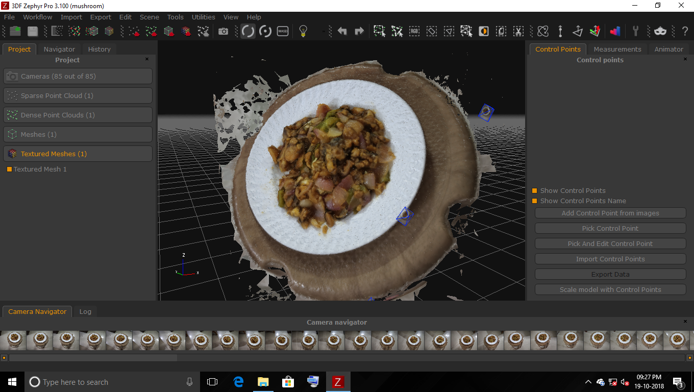

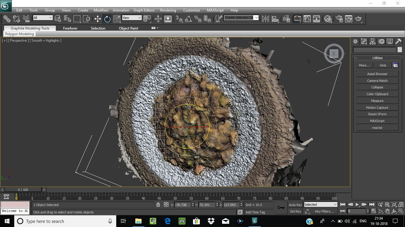

      Hey everyone, can yoy please help me with this? High Loss Of details while i am exporting my textured Mesh from 3DF Zephyr Pro and importing in 3ds Max. Tried both in Fbx and Obj format. Need help! Below are the screenshots
        #17
        Hi JyotiPrakash,
        i think you simply have never looked at the mesh in zephyr with lights on. Click on the lightbulb to make sure
        Export and import should be pretty straighforward
        • JyotiPrakash
          • Oct 2018
          #18
          Hi Andrea Alessi!
          The above image of zephyr is in light on mode. I always export with lights on in zephyr.
            #19
            in your screenshot the lights are off (click the lightbulb). Exporting with them on or off is the same, it's just rendering.
            If that's not what your issue is about however, try exporting in local coordinates, but from your screenshot i don't think local coordinates are the issue (the mesh would be blockier if the destination software didn-t support double precision)
