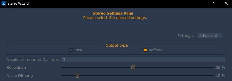

      As for the image resolution, you mean during the processing or the texturing phase? During the densification, the photoconsistency optimization and the texturing there's a slider to control the size of the images (50%, means that the images are downscaled by two both in width and height). Although it might seem counter-intuitive, since all the pictures usually have pixel level noise, I would suggest not to use a 100% resolution during the mvs phase as you might get more noise in the final mesh. During the texturing phase, you can instead increase the slider to 100% and use a higher number of textures (default is 4, but you can increase that number). The drawback is that the final model will be bigger to handle and render.

          You have to switch to "advanced" mode during the stereo/mesh wizard. It's the "resolution" slider.
          When using the presets, "default" set the resolution to 25% and high details to 50%

          all zephyr versions of course have the stereo wizard, otherwise you wouldn't be able to generate a dense point cloud. You're probably referring to the export dense point cloud feature which is available in zephyr pro and aerial only.
          As Roberto mentioned, make sure you're exporting the correct textured mesh when comparing in-zephyr rendering with other software. If you wish to increase the resolution for the generation, use the advanced settings as Roberto mentioned as well.

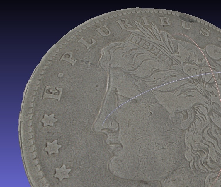

                  By doing so, you are exporting your textured mesh 1, which has this texture (here shown in meshlab so you can see this is independent from zephyr).

                  Which i think is what you wanted to export, here it is seen in meshlab.
