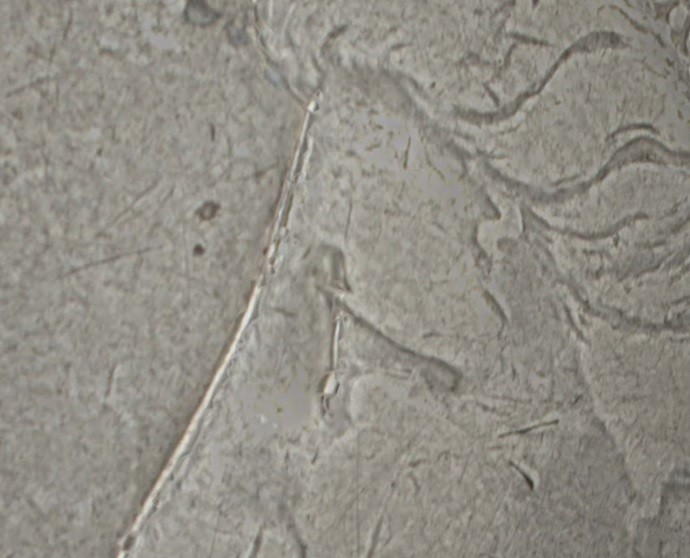

          #18
          Here are some general shooting tips https://www.youtube.com/watch?v=E06k...ature=youtu.be
          I personally shoot at ISO-100 or ISO-200. I don't see exif data on the file you sent me, but that's no issue for this specific topic:
          Simply look at your images at their 1:1 zoom or the texture generated by Zephyr.
          Click image for larger version  Name:	gregnoise.jpg Views:	1 Size:	535.7 KB ID:	2282
          that's ISO speed noise on your images. Which means either you're stuck using a lower resolution inside zephyr (See Roberto's post) or taking better images.

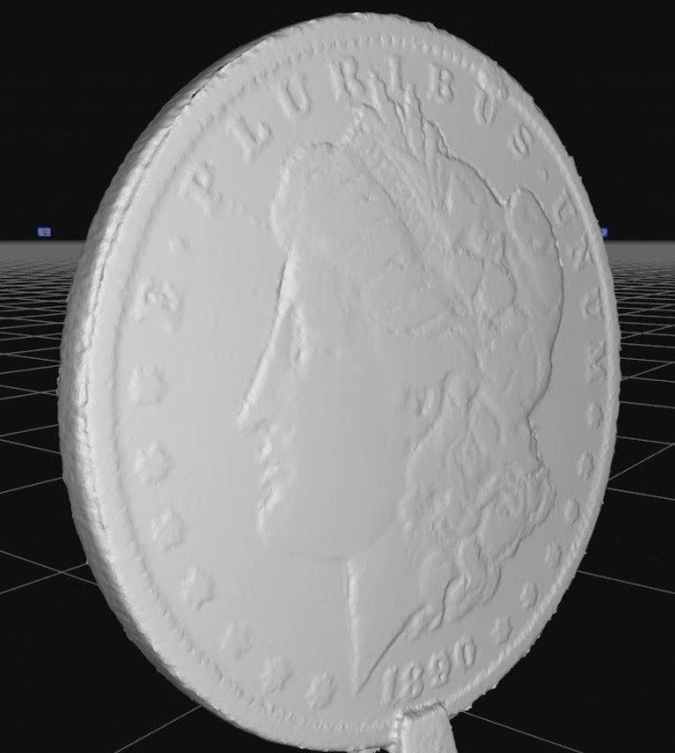

                  What is your target vertex count by the way? here is a simple result using presets (close range/default, close range/high details, close range/high details sharp features + additional PC, defaults 8k).
                  It is fairly low poly but looking at your screenshot you were aiming for something smaller? this one is 178k points (305k triangles). Let me know if you have a target vertex count so i can decimate it to your target as well for better comparison.
                  Click image for larger version  Name:	gregmesh.jpg Views:	1 Size:	57.8 KB ID:	2294

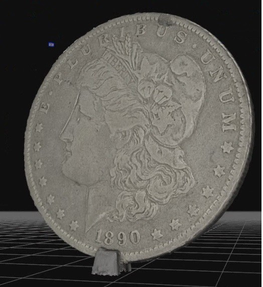

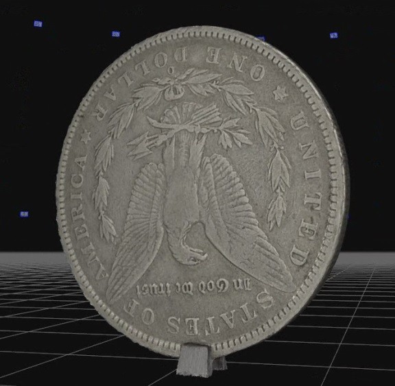

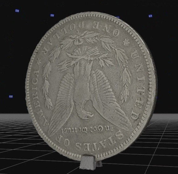

                  As for the texture, the new photos are better, as you can see with lower iso you get much less noise
                  Click image for larger version  Name:	gregtexdetail.jpg Views:	1 Size:	76.0 KB ID:	2295
                  Click image for larger version  Name:	gregA.jpg Views:	1 Size:	68.6 KB ID:	2296
