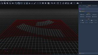

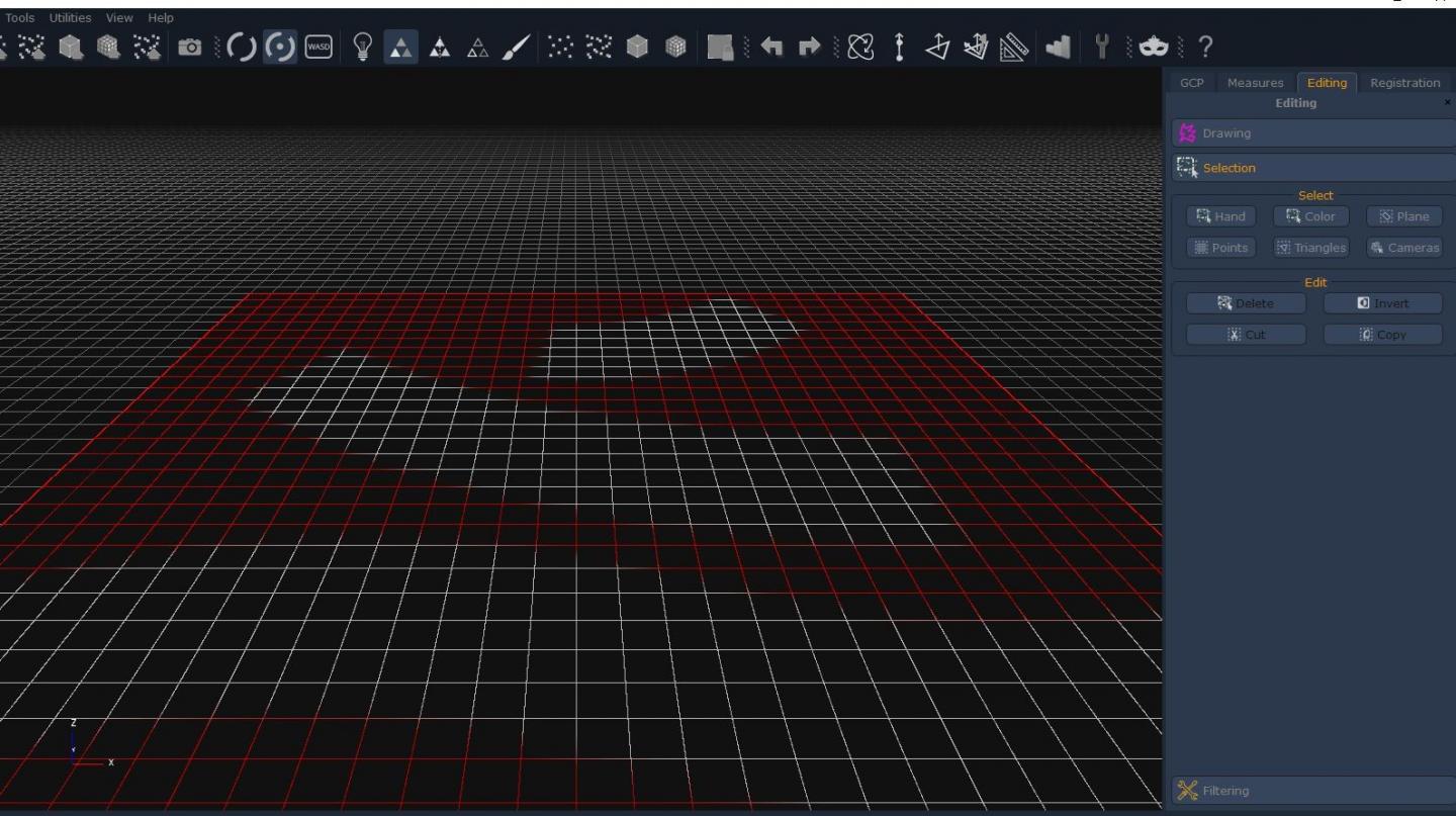

                Is the removal of the selection tools from the toolbar intended, or perhaps temporary ?
                I expect a lot of my current use falls outside the norm as I've been messing with pretty bad data that requires a lot of manual cleaning, so I could see why this might be acceptable to others. However, it seems like a step backward in usability.
                If they were available via hotkeys, I wouldn't miss the icons on the toolbar. Being a long time user of blender, and other similar packages, hotkeys are second nature to me.
                  The icon bar was becoming a little cluttered, and since we have introduced other icons for the selection, we decided to move it on the right dock. It's still temporary, and probably it will be moved above the "drawing" box (that is available only in the aerial version). We also added the filters there

                      Roberto OK, I see them now. I had actually closed that panel in Lite as I preferred a bigger viewing area for point clouds and meshes, so I didn't even look at what was there on the right. An Edit panel is certainly more convenient than going to the menus all the time.
                      I would find it better if you could fully utilize QT's ability to dock and split panes. Maybe I just don't know QT's paradigms good enough, but I would expect to be able to split panes and move things around to create a UI similar to the attached image (hacked together in GIMP). While I can move the Edit panel to the left side of the screen, I can only get it to be a member of the tabbed pane that has the Project, History and other panels.
                      The Edit panel comments aren't a big deal for me. I can always undock the panel and make it small when I'm using it and then hide it when I'm not. And if at some point hotkeys are added for the selection functions, I'd never see the edit panel again.
