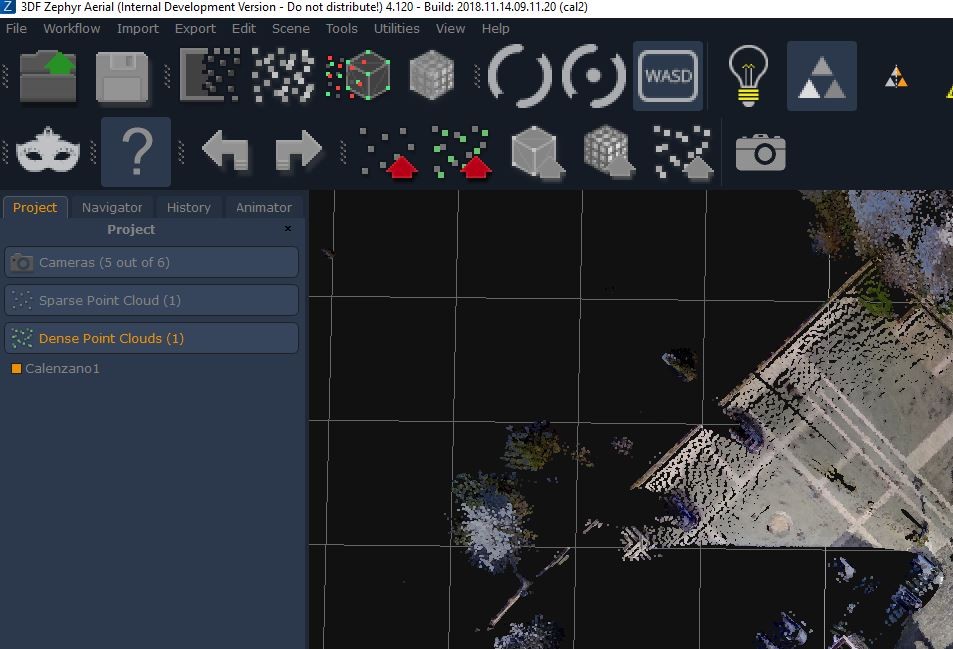

    Ok, we still have to fix a couple of icons, but you should now be able to set the size up to 64x64 sam3d
    (looking awful on my puny monitor )

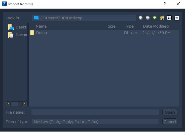

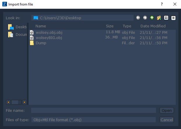

                            Import custom UV model. OBJ files don't appear in the 'meshes' selection (which should include OBJ files) - But does if you select OBJ+MTL. (Images attached)
                            Don't mind the .obj.obj file naming - I was just testing to see if it was a problem with naming structure - I don't usually do that
