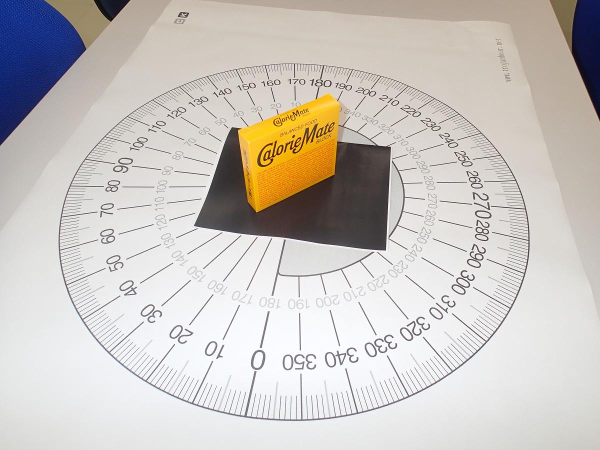

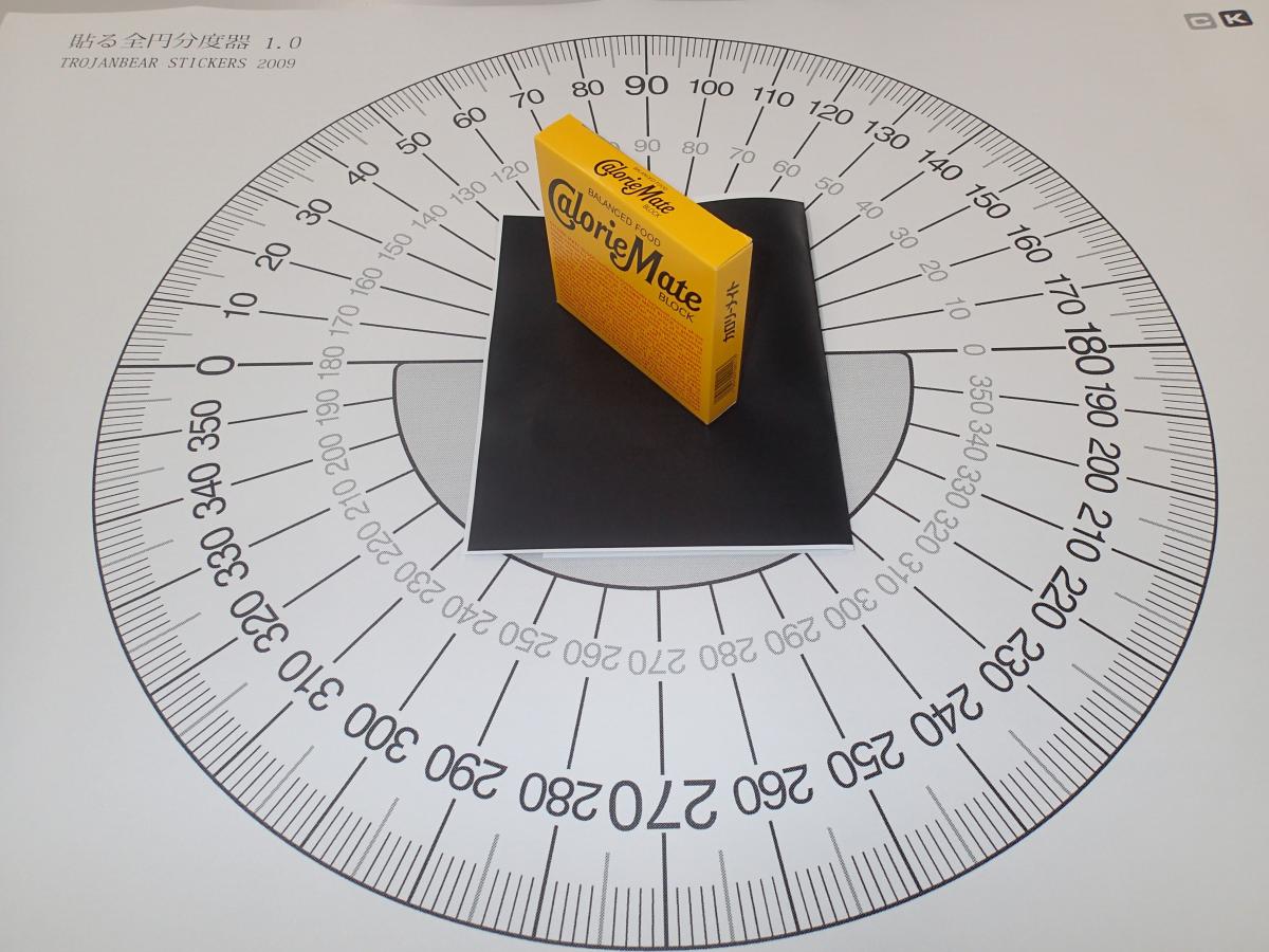

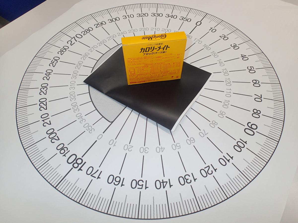

          Hi cam3d,
          Instead of big size dataset, I attached a few small size data (screenshots and photos).
          Do you get an image with these??(I hope you'll say Yes...)
          If not enough, please tell me.
          From the screenshots, I think the problem of "collapsed shape" is easy to realize.
          Regarding the blurring of the letters...
          To say annoying things, for example, the letter on the top of the BOX, barcode number, and some of fine letters are blurred.
          (If you think I should endure this much, please say so.)
          Thank you, Andrea
          However, I haven't used any third party service that you taught me (it's the first time I heard about these service), so I can't send dataset immediately. (Please give me time to study about them.)

              • 1386
              Hi mino,
              it's okay to take a couple of loops like that, to help with orientation, however do not move the subject or you will have to move the degrees wheel alongside your subject.
              moreover, you are using about 10% of the image with your subject, so try to take pictures of your subject much closer in addition to those "general" pictures of your subject.
