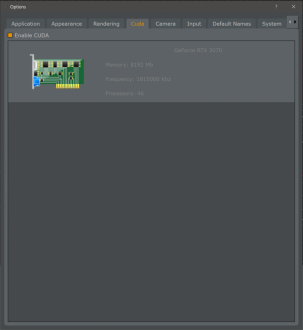

        Maybe it's because i was using only my cpu?
        but i don't even know if photoconsistency uses gpu at all....
          Bingo - Check you have the latest GPU drivers installed, and also head to Tools > Options > CUDA and make sure your GPU is enabled. You will see a massive speedup!
