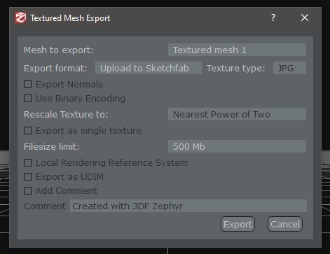

    I'm sure I may be doing something fundamentally wrong but I don't know what or can you not save a project.... can you only upload the finished item to Sketchfab? :/
    I did export the mesh (I think) but that disappeared too?

    With the free version of Zephyr you can save textured mesh files in a few ways rather than Sketchfab:
    - .ply
    - .obj/mtl
    - .glb
