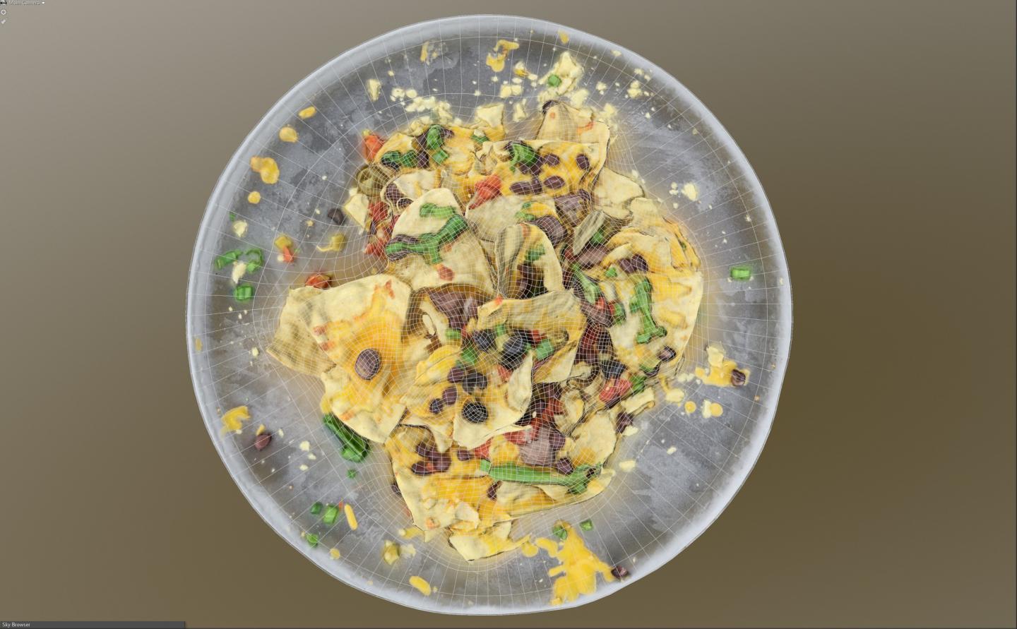

ID:	4035 Photogrammetry 3d Flow on the nachos and the other items traditionally modeled
