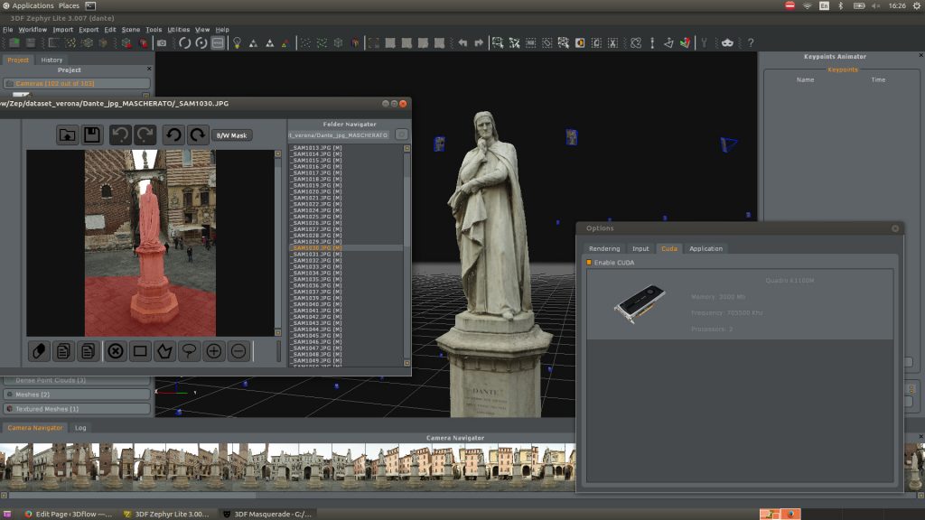

  • Step 2 – optional – Install the latest NVIDIA and CUDA drivers
click to view fullscreen
If you have an NVIDIA card, you can use the CUDA acceleration offered by the latest Wine > 1.9.x releases. In Ubuntu, installing the proprietary driver can be done easily via the Settings/Additional Drivers window. Make sure to select the latest available driver.
You may install CUDA directly with the package downloaded from the NVIDIA website or by typing
$ sudo apt-get install nvidia-cuda-toolkit
Up to 3DF Zephyr 3.007, you need CUDA 7.5.

  • Step 4 – install 3DF Zephyr
At this point, you can normally install and run 3DF Zephyr. Although we do not officially support this deployment mode, please feel free to post in the forums anytime!
Although both Zephyr and Masquerade have been tested an are working correctly, we have not yet tested our plugins 🙂 but we will soon!
