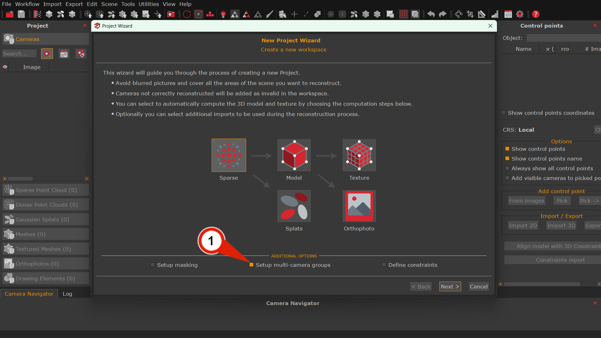

To begin the workflow, click on the menu “Workflow” > “New Project”.
In the New Project Wizard page, select the check-box “Setup Multi-Camera Groups” (1), then click on the “Next” button.
